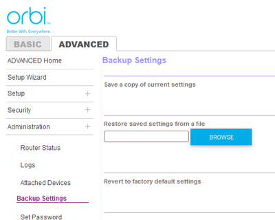

Thanks for the tips. I keep getting an error saying "please select the correct configuration file" when I try to select the .img file from the download. I'm using chrome as a browser. Any ideas?!?

There is a separate menu item for saving and restoring a configuration file.

When I go to the backup settings page and try to upload the RBS50-V2.2.1.212.img I get an error saying "Please assign the correct file. The file format is *.cfg" đ

try going the version right before that version. Sometimes you need a stepped process or something has changed in the process.

That was it. I first updated them each around 4 times each to finally get to everything to 2.7.4.24!
