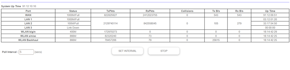

That it why it is useful to verify on the Orbi router what speed it is using. If the Orbi has determined that the correct speed is 100Mbps, then that is the maximum possible throughput. On the router web interface, open the Advanced Tab home page, and click the blue box Show Statistics.
- eliwooApr 03, 2022Star
Looks like LAN 2 is running at 100 Mbps. actually I crimped the cable myself, so maybe i did a poor job of it.
