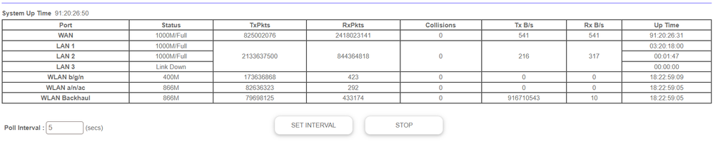

That it why it is useful to verify on the Orbi router what speed it is using. If the Orbi has determined that the correct speed is 100Mbps, then that is the maximum possible throughput. On the router web interface, open the Advanced Tab home page, and click the blue box Show Statistics.
- eliwooApr 03, 2022Star
Looks like LAN 2 is running at 100 Mbps. actually I crimped the cable myself, so maybe i did a poor job of it.

Before cutting the plug off, I would reconnect the cable to the computer and see how the Orbi router reports the connection. If it shows 1000/Full, then it might be the jack on the satellite. (I now have a special pair of reading glasses just for looking at tiny things "up close".)
okay here is the same cable plugged into my workstation. you can see now its showing as 1000 speed, and i am indeed getting up to 1000Mbps speedtesting.
not sure what this means, is it possible the crimping is defective and works for my workstation hardware but not for the RBS50?

okay after replacing the cable i am indeed getting gigabit speeds across wifi and lan through the RBS50.
I feel dumb for assuming because the the cable delivered 1000Mbps to my workstation, it would also have the same performance on the RBS50. i guess the satellite is a bit picky.
