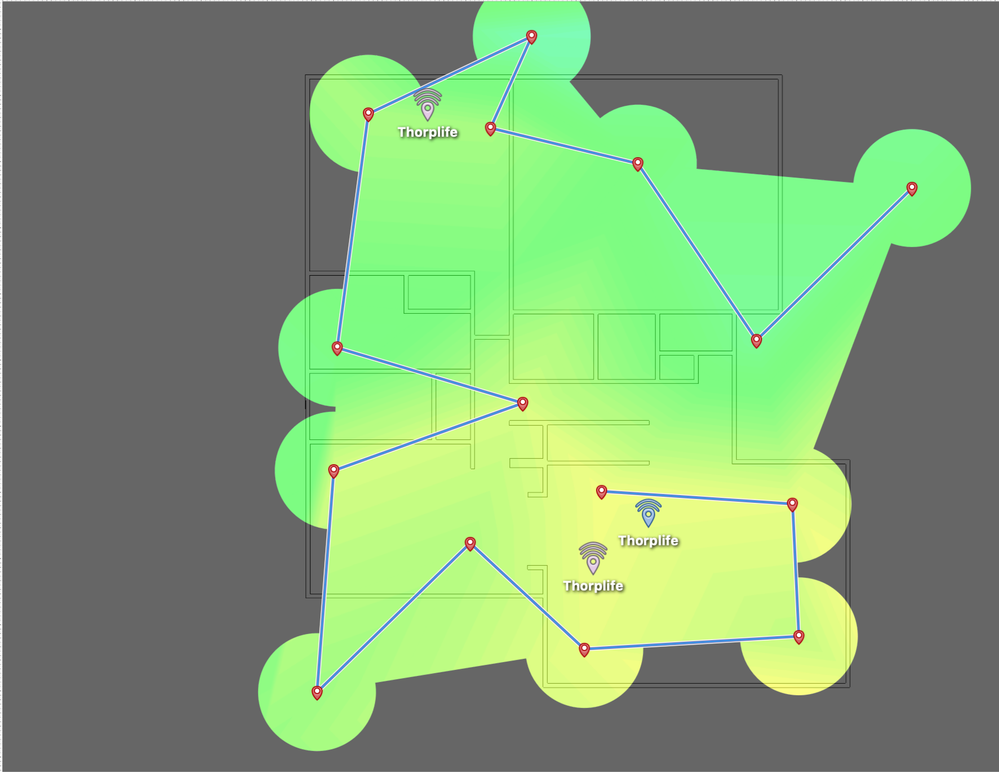

I wanted to post an update, you never know who might be searching with a similar problem in the future. I decided to order and new RBS50 as my faulty unit was out of warranty. Once installed everything is working as expected. The old unit fronthaul hardware failed at some point.
I'm attaching a new scan (1st level only). In this scan you will only see the new RBS50 and the RBW30 AP's. The scan did not pickup the RBR router (even when I'm close). I believe the satellite is a little too close to the router. The satellite is positioned a floor higher and thus I think clients are giving it preference due to the open loft layout of that room. I'm not worried as the RBR router shows wireless clients attached in the GUI. I'll tweak router and satellite placement in the future but for now I'm just thrilled everthing is operating with low signal to noise and fast speeds.
