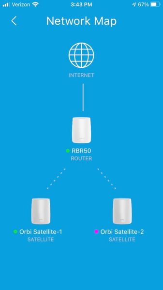

Thank you all. I def did the 'Factory Reset' on the satellite. Pic # one (1) is of the Orbi app showing the available network [Internet -> RBR50 (w/ green dot) -> Orbi Satellite-1 (w/green dot) & Satellite-2 (w/purple dot). Pic # two (2) was from orbilogin.com on the 'Attached Devices' screen. I see this:
Status Device Name IP Address MAC Address Connection Type Connected Orbi Backhaul Status 1 Netgear Orbi Satellite-1 10.0.0.2 10.0.0.2 3C:37:86:2A:3B:CB 5G Orbi Router
08:36:C9:13:77:6CGood 2 RBS50 Orbi Satellite-2 - - B0:B0:8A:59:FD:93 - - Disconnected Hopefuly you see this. If not, it shows Device Name (Orbi Satellite-1 with the IP address, MAC address, Connection Type, Connected Orbi, and Backhaul Status as good. Satellite-2 onlly shows: the device name, the MAC address, and the Backhaul Status (disconnected).
