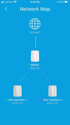

RBS50 not connecting, needs firmware update, help please!
Already own a RBR50 with 1 RBS50 satellite. Purchased used RBS50's to add to system. One was recognized but not connecting to system. I am unable to udate the firmware or properly connect. Suggesi...

So simple yet so true. Thanks... Once I got in and updated the firmware to be the same as the rest of the ecosystem the entire thing worked itself out.
Appreciate the help!
