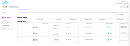

RBS50 shown under "Connected Devices", but not under "Connected Satellites"
I have Orbi RBK50 in AP Mode with ethernet backhaul. I ran through all possible suggestions from this forum on how to get the enternet backhaul working properly (posts like this one https://community...
- Aug 02, 2018OK, problem solved. I just remembered that someone suggested not to connect the RBR50 to the router through the WAN port.
I just moved the cable to ETH1 port, restarted the RBR50 and RBS50, and voilà, the RBS50 shows normally under connected satellites.

The satellite is working fine. It's connected to the ASUS Router, just like the RBR50.
