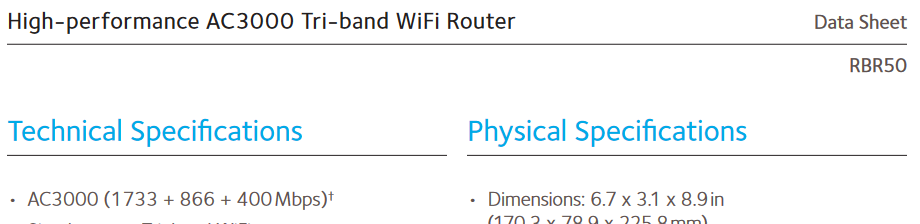

Before Netgear removed the command line interface (telnet), there was a command that could be run to display the actual Link Rate between the router and each satellite. I enjoyed observing how true that tiny footnote in the Product Data Sheet was about the backhaul Link Rate was. Notice the original RBR50 claimed a "speed" for the backhaul connection of 1733 Mbps:
And here's the footnote:

Instead of the connection being 1733Mbps, it is actually 780Mbps. This is still plenty fast for my needs and faster than my ISP connection.
