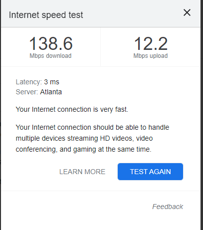

Update: Been running fine with the Amazon Fire tablet's wifi set to OFF.
tested Download speed 138.6 upload 12.2 latency 3ms

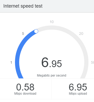

Connected Amazon Fire Tablet to Orbi. Downloaded latest Fire OS 7.3.2.2.
Speeds dropped. I can consistently reproduce this problem every time now. never fails...i connect the amazon tablet, i have to turn off the WIFI then restart the orbi to make it go back to normal.
