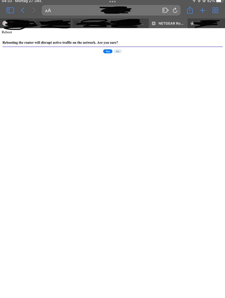

http://ip-of-satellite/reboot.htm allows you to reboot a single satellite
- FURRYe38Dec 26, 2021Guru - Experienced User
Got a screen capture of this?
Ha_Ku_Na wrote:
http://ip-of-satellite/reboot.htm allows you to reboot a single satellite - CrimpOnDec 27, 2021Guru - Experienced User
Ha_Ku_Na wrote:
http://ip-of-satellite/reboot.htm allows you to reboot a single satelliteThanks for finding this. Yet another undocumented feature, along with
