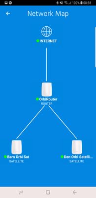

I had recently posted on here that although my Orbi system was running well, the Orbi app would not list devices under the "Network Map" option. I have tried all sorts of things to get this to work ...

Chuck_M
Jan 13, 2019Mentor
Names changed to RBR50, RBS50_1 and RBS50_2.
- Result: No apparent change.
- The Device List still doesn't show fields for DEVICE TYPE nor does it show fields for CONNECTED ORBI
- The network map continues to report "No Connected Device Found"

So how do we determine where this communication issue is? On android Orbi app, works at neighbors, doesnt work here. On Apple device, works here.
Here is another interesing datapoint I just found: If you bring up (on Android), Device List... they are missing DEVICE TYPE and CONNECTED ORBI fields. If you click EDIT ITEM... it will ask you for the DEVICE TYPE. If you put it in, it will stay there until you refresh the device list, but will still not populate the network map. Once you refresh, the DEVICE TYPE for that device you edited will disappear again.
It seems to me that the critical field in this case that is having commo issues is the CONNECTED ORBI field -- which of course would drive the network map display -- although device type is also problematic.

- Chuck_MJan 14, 2019Mentor
SOLVED ISSUE Of Network Map Not Rendering Properly and Showing Devices By Connection On Android!!!!!!!
BLUF: My original local SSID was "Daily Planet" The Space in the SSID was preventing the "CONNECTION TYPE" and "CONNECTED ORBI" fields from being reported to the Orbi App! (My neighbors SSID is only 4 characters long with no spaces so theirs worked properly)
This only affected Android devices running the Orbi App... Not Apple Devices

Orbi and the Orbi APP CANNOT HANDLE SSID's with spaces in them. They will not render the network map properly if so.
To resolve: Take out the spaces -- replace with underline and it should work properly!!!!!!
