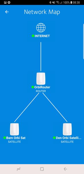

Same Model System, Different Behavior??
I had recently posted on here that although my Orbi system was running well, the Orbi app would not list devices under the "Network Map" option. I have tried all sorts of things to get this to work ...
- Jan 13, 2019
SOLVED ISSUE Of Network Map Not Rendering Properly and Showing Devices By Connection On Android!!!!!!!
BLUF: My original local SSID was "Daily Planet" The Space in the SSID was preventing the "CONNECTION TYPE" and "CONNECTED ORBI" fields from being reported to the Orbi App! (My neighbors SSID is only 4 characters long with no spaces so theirs worked properly)
This only affected Android devices running the Orbi App... Not Apple Devices
Process I took per FURRYe38 recommendation:
- Disconnected satellites (2 of them)
- Hard reset Router
- Rebooted & initial set up
- Tested (It didnt work since I used my original SSID "Daily Planet")
- Reverted to an Earlier Firmware version thinking that may help -- rebooted and set up but used the default SSID (ORBI38)
- Noticed all was working properly!
- Changed SSID to "Daily Planet"
- Noticed it DIDNT WORK again with an SSID with a space in it
- Changed SSID to "Daily_Planet"
- Noticed it was working properly!
- Updated Firmware to current version
- Verified it is still working properly on all android devices.
- Turned back on Satellites
- Updated Settings for Reserved IPs etc and reattached wireless devices with new SSID
- Poured myself a cocktail and am a happy man!
Orbi and the Orbi APP CANNOT HANDLE SSID's with spaces in them. They will not render the network map properly if so.
To resolve: Take out the spaces -- replace with underline and it should work properly!!!!!!
A couple of heroes out there who deserve recognition for helping & discussing this
Pass the word. If you have spaces in your SSID, Android phones will not render the Attached devices properly under the DEVICE LIST nor the NETWORK MAP!
