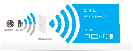

Satellite connected to 2.4 Ghz, not 5 Ghz?
Just set my system up, updated to latest firmware, but now downgraded to see if that solved anything. Currently I am on 1.11.0.20. When connecting to the satellite, I get the picture below showing 2...

- mickiiiAug 13, 2017Tutor
I have now tried to update and reset the devices, but the issue remains. The communication between the main and the satellite jumps to 2.4 Ghz only after a while. Any other suggestions? Is this a know error?

- mickiiiAug 15, 2017Tutor
I just did a test, getting 300Mbps (my connection is 300Mbps), so full speed. I then checked the satellite "page" in the browser, and sure enough, it had all parts of the image in blue. I then ran it a minute later, and then it maxed out at 170 Mbps. I then checked the page again, and now it is greyed out between the router and the satelite on the 5 Ghz band again. It is as if once it is "maxed" it turns "something" off, throttling the communication between the routers?
