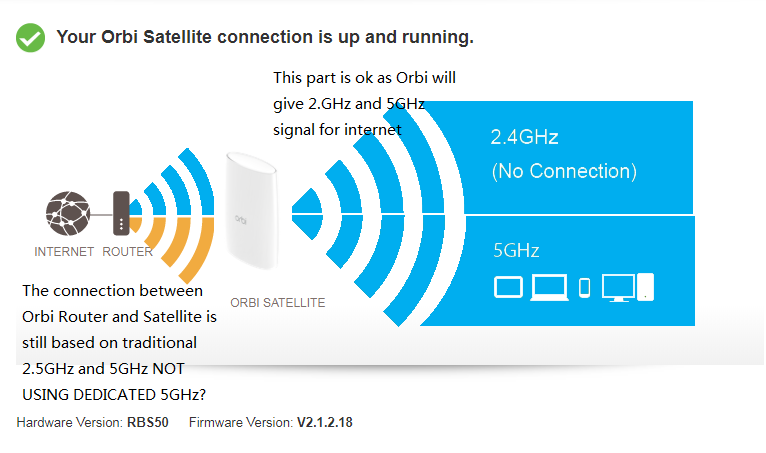

Satellite connected to 2.4 Ghz, not 5 Ghz?
Just set my system up, updated to latest firmware, but now downgraded to see if that solved anything. Currently I am on 1.11.0.20. When connecting to the satellite, I get the picture below showing 2...

I just did a test, getting 300Mbps (my connection is 300Mbps), so full speed. I then checked the satellite "page" in the browser, and sure enough, it had all parts of the image in blue. I then ran it a minute later, and then it maxed out at 170 Mbps. I then checked the page again, and now it is greyed out between the router and the satelite on the 5 Ghz band again. It is as if once it is "maxed" it turns "something" off, throttling the communication between the routers?
- Mgomez85Aug 19, 2017ApprenticeThat pic u see of the satellite unit is not your connection to the main unit but connection to your clients! I was also thrown off by that at first until I notice what it means, all that tell you right now that all your clients connected to your sat unit is in your 5G connection once a device switches to 2.4 it will show you that a 2.4 connection is established. Hope this helps

thats what i am so confused. Why my Orbi satellite still receive 2.5GHz and 5GHz from Router, not using 5GHz-D as connection between Router and Satellite.

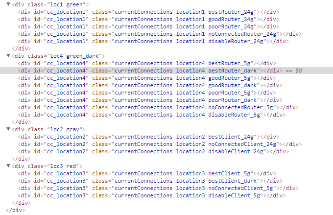

After checking the HTMLcode, I think what i said was right, there must be some problem with the satellite signal page design or Orbi cheat customer? There shows no 5GHz-D backhaul for connection between Router and Satellite. Satellite still use traditional 2.5GHz and 5GHz for R&T
