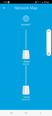

I got a refurbished RBR40 converted to a RBS40 satellite and cat5e cable to go with my RBR40 router for house to backyard shop project.
I can get the satellite connected to the router--> my app shows the satellite and router with a green dot.
However, the satellite doesn't seem to be WiFi'ing . My phone, computer or TV don't detect it.
What setting am I missing to make this work?

Appreciate the answer. I have been on the Orbi website
Again, I am connected but sateliite doesn't seem to have a signal.
Access Control: Turned On
General Rule: Allow all new devices to connectConnected SatellitesStatus Device Name IP Address MAC Address Connection Type Connected Orbi Backhaul Status 1 Netgear Orbi53 192.168.1.11 192.168.1.11 A0:40:A0:5C:E8:4B Wired Orbi Router
78:D2:94:52:AA:90Good Connected Devices
