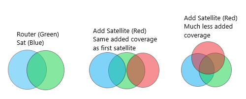

      Retired_Memberis correct.  Where the new satellite is placed affects how much "more coverage" is achieved.  One may be tempted to do some basic math:  A circle of radius 30 ft has an area of 2,827 sq. ft.  Wow!  Of course, part of that coverage may be toward the neighbor's house which means basically "wasted".  Add a satellite and get 2,827  MORE sq. ft.  NO.  A lot of the satellite "coverage" will overlap with the original router coverage, i.e. not "more".  Adding a second satellite directly in line with the existing router-satellite will potentiall add as much as the first satellite did.  However, put the new satellite off to the side, and it will overlap both the existing router and satellite.  Thus adding much less coverage than the first satellite did.  Here's a brief diagram:
      If you have an area with poor signal, adding another satellite is a good idea.  I have done so, and it helped.
