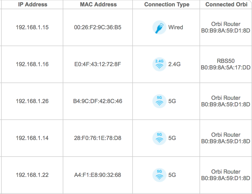

Ideally, yes. And most of my important wifi devices do run at 5G (or are at least capable of it). However, since I have kids, they still have devices such as Nintendo DS that know nothing about 5G speeds, etc. So I need to leave it enabled for the odd times they want to fire those devices up.
Here's a good question:
Why doesn't the Netgear console report what SPEED each of the connected devices are using?
Clearly, the router knows this information, since it negotiated the connection for each wifi device. This would be a fantastic bit of troubleshooting information, yet its not available in either the basic or advanced Devices sections of the admin console. And since Orbi uses a single SSID (which is great) it also obscurs what speed each of the devices are using. Previously, we knew the connected speed for each device implicitly by its associated SSID, which was always associated with a specific frequency. That's all changed/hidden now. But if I could confirm that ALL my current wifi devices were operating at 5G speeds, I might feel more comfortable disabling the 2.4G speed completely until and if it is actually needed. But at this point, I have no idea if my Orbi is spreading all my devices across both its 2.4G and 5G radios to maximize parallel throughput or not. It's a black box right now.
- MrgoodallFeb 07, 2018Star
It actually does ... go to administration > attached devices ...
