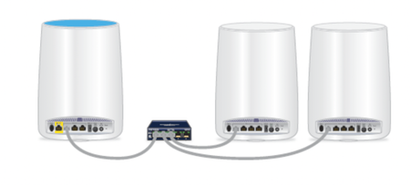

Setting up wired backhaul
HI all, I am taking another stab at getting the RBR/RBSS850 set up in an old big house with lost of thick walls etc.! This time, I have been getting all the rooms wired with Ethernet, done! My curre...

CrimpOn
Feb 12, 2022Guru - Experienced User
A lot of people prefer an incremental installation process for Orbi satellites:
- Plug one in while in the same room as the router.
(If it does not sync, then there is a problem) - Connect the satellite to router with an ethernet patch cord.
(again, if it does not sync in 4-5 minutes, there is a problem) - Finally, move it to the desired location and connect the ethernet.
(If it does not sync, that puts the focus directly on the ethernet wiring, as the satellite has already been proved to function correctly.) - Repeat with next satellite.
