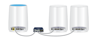

Setting up wired backhaul
HI all, I am taking another stab at getting the RBR/RBSS850 set up in an old big house with lost of thick walls etc.! This time, I have been getting all the rooms wired with Ethernet, done! My curre...

A lot of people prefer an incremental installation process for Orbi satellites:
- Plug one in while in the same room as the router.
(If it does not sync, then there is a problem) - Connect the satellite to router with an ethernet patch cord.
(again, if it does not sync in 4-5 minutes, there is a problem) - Finally, move it to the desired location and connect the ethernet.
(If it does not sync, that puts the focus directly on the ethernet wiring, as the satellite has already been proved to function correctly.) - Repeat with next satellite.

- donawaltFeb 25, 2022Hero - Experienced User
Hi, as promised I am checking back with results! Everything worked fine, the network is running great! We have a rowhouse, about 4500 square feet with 3 floors and a basement. We have Comcast 1.2/40 service. I have an RBR850 in the basement where the cable comes in (somewhat in the center, thanks to a long cable), an RBS850 in the dining room on the first floor roughly 1/3 of the way in from the back of the house, nothing on the second floor, and another RBS850 on the third floor roughly 1/3 the way in frm the front of the house! All are well more than 30' from each other. I was very careful studying signal strength as I added the devices one at a time, as a result I only need two satellites, and the speed test results are great everywhere! The router handles the basement and 1st fl. living room at the front of the house, the RBS in the 1st fl. dining room near the back handles that room and the bedrooms on the 2nd floor right above it, and third floor RBS handles that floor (it's smaller than the other two floors) and the 2nd floor bedroom in the front of the house. Since I have about 24 Ethernet runs to different rooms, not only are the 2 RBSs wired for backhaul, but our 2 laptops, and 2 Apple TVs are wired. The rest of the Ethernet runs are not needed for now.
