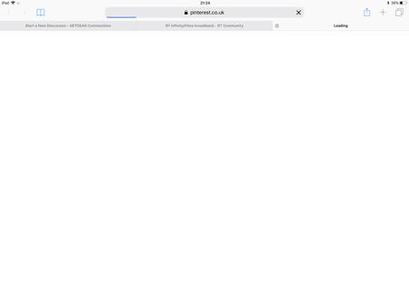

Hi all, I installed the Orbi RBK40 yesterday in my home and installed the 2.1 firmware as I bought this device to use with Circle. I have noticed that periodically websites will not load, current...

Last night I turned off IPv6 in case that was causing an issue but the circle support page still didn’t load, however once I turned WiFi off and on it did start working. I then disconnected and reconnected the internet through the Orbi interface and the circle support webpage started to load. However this morning it was again refusing to load.
I am also getting a lot of timeout messages when using the circle app, this morning I have disabled circle and then re-enabled it. Now the support page is working again, see how long it lasts today

I reset the router to factory defaults and once circle was enabled again, the circle support site refuses to load. It must be a bug, if anyone else that uses circle wants to try it and see.
Hopefully it it will not randomly block any other sites, even when the device is unfiltered it does not work so must be a bug for that particular site.

I'm running Circle with 2.1.2.18 and I can access the Circle app and Pinterest.
The router is pretty much at default configuration, OpenDNS Parental Control disabled, no wired backhaul, no guest Wifi...
