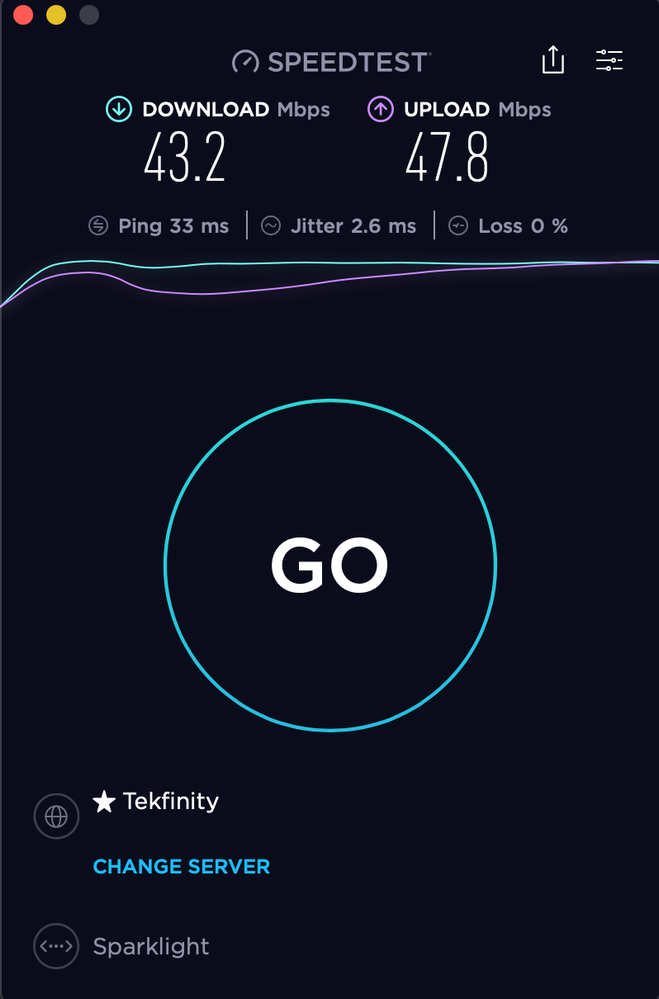

Slow ethernet and wifi satellite speeds
My devices that use an RBS20 satellite are very slow. The speeds are roughly 30-50mbps. Doesn't matter if it is a wifi connection to the satellite or a wired ethernet connection to the satellite. T...

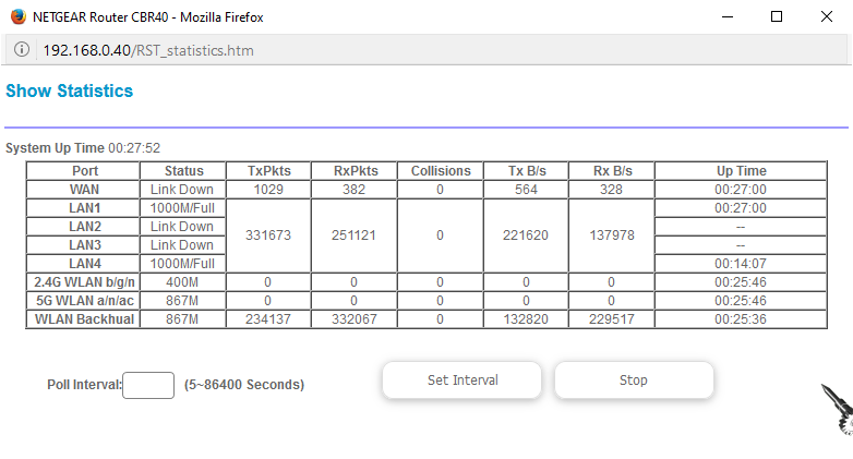

Ok, after FINALLY getting my RBS20 to connect to the CBR40, Having my RBK50 online doesn't help so RBS kept getting confused. :smileyfrustrated:

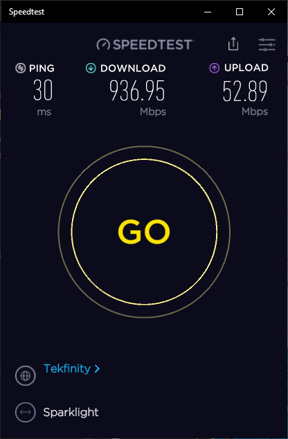

So seems to be a speed problem for sure with a wired PC connected behind the RBS20 thats connected to the CBR40:
I did a wire test thru the CBR to be sure wired is ok:
Connection rate is good and seems to be working:
CBR40 is in a faux AP mode since I don't have it connected to my ISP cable line. DHCP server disabled and the CBR40 LAN port connected to my RBK50 network.
Beamforming, MIMO, FR and WMM are enabled on the CBR. Manual Channel 11 and 48 as my RBK50 is on 1 and 36. I even turned down the power output of the RBR50 to lesson the interference.
I would make contact with NG support and open a support ticket. This needs to be looked at.

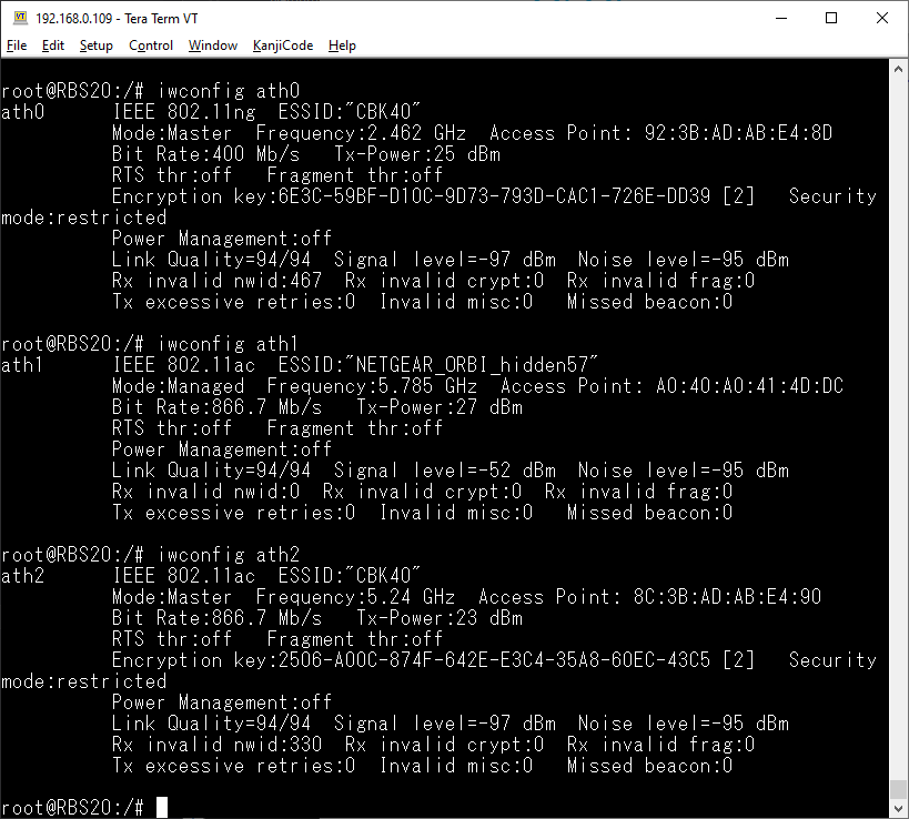

FYI, I was curious where the problem appeared. Seems to be on 2.2.1.210 as I reverted my CBR40 an RBS20 back to v210 today. Factory reset both CBR and RBS. Still same 50Mbps on the down with a wired PC connected to the back of the RBS20.
I reverted back to v2.1.4.6 on the CBR40 and v2.1.4.16 on the RBS20. Powered OFF both units for 30 seconds then back ON.
Look what the results were:
Seems that something broke in FW after v2.1.4.x
