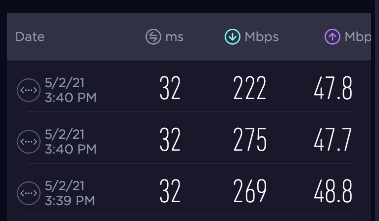

FYI, I was curious where the problem appeared. Seems to be on 2.2.1.210 as I reverted my CBR40 an RBS20 back to v210 today. Factory reset both CBR and RBS. Still same 50Mbps on the down with a wired PC connected to the back of the RBS20.
I reverted back to v2.1.4.6 on the CBR40 and v2.1.4.16 on the RBS20. Powered OFF both units for 30 seconds then back ON.
Look what the results were:
Seems that something broke in FW after v2.1.4.x
