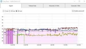

Solid connection to constant drops on all channels
Using RBR20 and one Satellite - Firmware 2.5.1.16. Downloaded Netspot to look at why I was constantly getting drops. I initially thought it was my internet connection but it's my WiFi. I restarte...

Further to the changes you suggested yesterday I reset the modem. In doing so it reverts to the dual modem/router functionailty. I ran it this way for approx. 30 mins (eliminating Orbi from the chain). I reviewed the NetSpot logs and saw exactly the same issues - solid then bouncing. The bouncing started at the moment I was on a videoconference.
I then went back to bridge mode and utilized Orbi. Again, performance was stable until I had another VC, then more bouncing. I tried this a few times and every time the VC kicked off the eratic signal strength.
Next step, I restarted my PC. Everything has been stable for 15 hrs since, including through multiple VCs. I think it's solved. Was it a combination of the changes and a PC restart?
