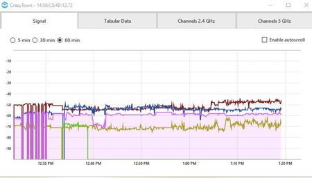

Solid connection to constant drops on all channels
Using RBR20 and one Satellite - Firmware 2.5.1.16. Downloaded Netspot to look at why I was constantly getting drops. I initially thought it was my internet connection but it's my WiFi. I restarte...

Modem: Rogers Hitron CODA 4582. No factory reset or setup from scratch since last FW upgrade. I'll come back to this if needed. Why would this impact what I'm seeing with the wifi channel strength?
Size of home: Approx. 4800 sq ft over 3 levels (one of which is a basement)
Channels: Was Auto but now changed to 1 and 36. Four neighbours' SSIDs can be seen.
I've disabled everything recommended, saved and rebooted.

Yes, was already in bridge mode, with the modem not being used as a router.
Further to the changes you suggested yesterday I reset the modem. In doing so it reverts to the dual modem/router functionailty. I ran it this way for approx. 30 mins (eliminating Orbi from the chain). I reviewed the NetSpot logs and saw exactly the same issues - solid then bouncing. The bouncing started at the moment I was on a videoconference.
I then went back to bridge mode and utilized Orbi. Again, performance was stable until I had another VC, then more bouncing. I tried this a few times and every time the VC kicked off the eratic signal strength.
Next step, I restarted my PC. Everything has been stable for 15 hrs since, including through multiple VCs. I think it's solved. Was it a combination of the changes and a PC restart?
- FURRYe38Jan 27, 2021Guru - Experienced User
So if you saw with with out the Orbi in the mix, I presume it was the changes you did and someting on the PC that seems fixed after you rebooted it.
Please mark your thread as solved so others will know.
