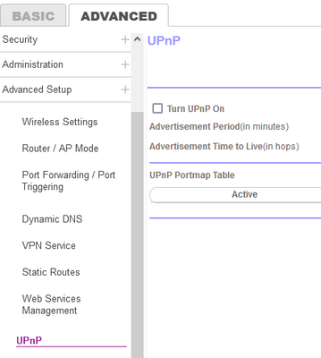

Can you check what appears in the Advanced Tab, Advanced Settings, UPnP menu:
My Orbi has UPnP disabled. Nothing on my LAN can forward any ports. When I want a port forwarded, I have to use the Port Forwarding menu and set up the port forwarding myself. (If I had a NAS, things would probably be different, but Christmas has passed and Santa did not leave one under the tree.)
- On the Orbi web interface http://orbilogiin.net ) the Advanced Tab home screen will show the IP address assigned to the Orbi WAN port:
