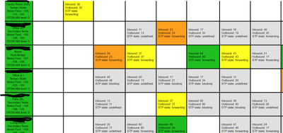

Yeah my friend / client has three places in Colombia SA and I have been to all three and all three have Sonos systems and these RBR50 routers with RBS50Y and or RBS50 sats and his one system in Jardin which is close to my house is the only one giving issues. But then it is the biggest of the 3 systems with the main router and 3 sats for the Mesh network and 16 Sonos pieces scattered throughout the house and even outside the house. So I have been working on fixing his Sonos speaker dropouts for many years now (Luckily, he doesn't use his house here much 🙂
Usually when I am there at his house testing the system it of course works 100% fine but then when I leave it starts acting up again.
I will be checking over in the Sonos forums for some help to see what direction they may be able to point me in.
I do not like what I see in the Sonos Support Info page of his system:
