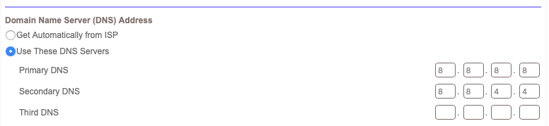

Certainly... This screenshot shows the changes:
Modified DNS

I should add that the site is also inaccessible with this change... Really puzzling stuff... Maybe I should reconnect the Securifi Almond+ temporarily and run "traceroute" to compare. I retired the Almond+ because it lacks Mesh WiFi, which I need for my 2-story home.

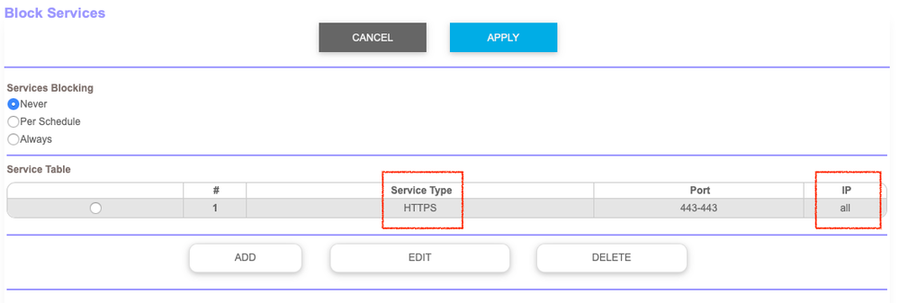

Is the problimatic site an https site? Do other https sites work well? Please try the solution here for a test: https://community.netgear.com/t5/Orbi/Orbi-Blocking-Websites-Solved/m-p/1677125/highlight/true#M74168

- Casey_SJApr 05, 2020Star
Just went through the linked thread. Changes made as follows:
Orbi did not reboot after clicking "APPLY". But the website in question remains inaccessible. All other "https" sites are still okay (which includes this one -- community.netgear.com).
You may be right about a possible conflict between the Orbi router and cable modem. The new modem (Arris SB8200 DOCSIS 3.1) should be delivered on Wed or Thurs of the coming week. I'll certainly update this thread if the problem disappears after switching to the new cable modem.

One more thing to try, to make sure that the new DNS change took place. Please go to >> ADVANCED >> Setup >> Internet Setup >> and click on "Test". This will make sure that the new DNS settings will take place. Please test after that.
Please try different DNS servers like 1.1.1.1, 8.8.4.4, .....
After changing Primary DNS to 1.1.1.1 and secondary DNS to 8.8.4.4, I captured a screenshot and attached it here. Clicked APPLY, then clicked TEST. The router rebooted.
But alas the website remains inaccessible...
