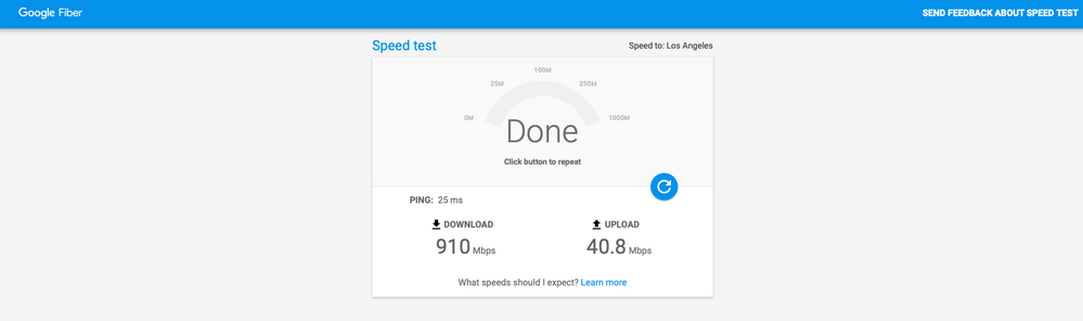

- SW_Dec 29, 2019Prodigy
An example of my speedtest result.

speed test run on Orbi device from ethernet connected desktop: 790.24Mbps 42.07Mbps <Cat 6A cable connecting to Netgear 10G switch (listed) connected by 6A to Orbi connected by 6A to Xfinity Gateway
