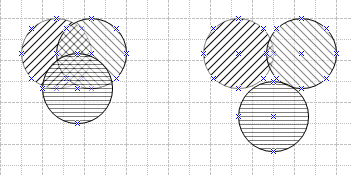

- CrimpOnDec 19, 2019Guru - Experienced User
I think the key element is "hardwired". When using the 5G WiFi backhaul, I would want the satellite to be close enough for the Orbi to report the backhaul link as "Good" rather than "Poor". This means that the router and satellite user radios also are going to have "good signal" from the router when they are right next to the satellite. With two good signals to choose from, my guess is it doesn't matter which radio the user device picks. "Service is great. Enjoy it." Keeping the radio at full power allows service to extend farther in the direction away from the radio.
I would think that hardwired satellites can be placed quite a bit farther away than WiFi backhaul as long as that does not create "holes" in coverage. Consider having three Orbi units. On the left, each unit is close enough to have "Good" 5G backhaul, and many devices get good signal from more than one. On the right, using wired backhaul, they can be placed where user devices get "good" signal from only one Orbi. Total area covered with good signal is larger.
Of course, the physical layout of the building matter a lot. There's not a lot of purpose in providing good signal to locations where there are never any user devices. Many of us prefer to wire some of our user devices to Orbi ethernet ports, which also affects where the Orbi is placed.
