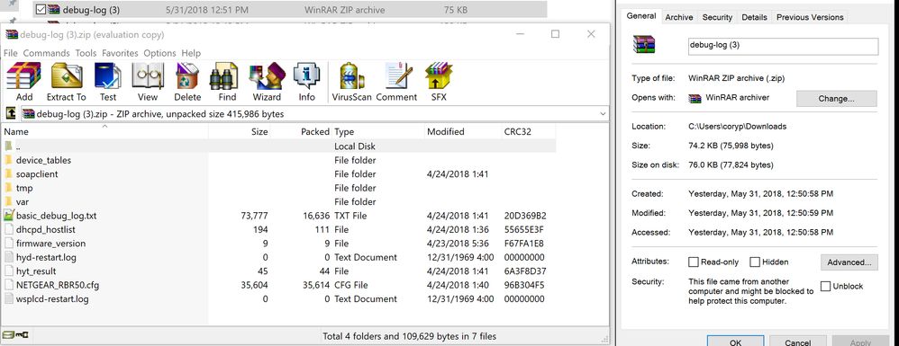

- Brain29Jun 01, 2018Apprentice
hopefully this dosent get compressed so you can't read the text
but the file was created after a reboot of the orbi on 5/31
but the orbi thinks its 4/24 and has also created some files in 1969
** the time stamps for the created files are what the orbi is also sending to all devices
** all the logs are bascially blank and only show newly connected mac addresses of my devices trying to reconnect
** after the time fixes itself all the logs timestamps change to the current time
