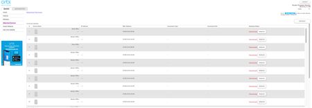

Too many satellites, how to do i remove them
How do I fix this, see the attached screenshot. There are 52 listed and using the remove button does not work. I'm on the latest firmware and have rebooted everything at least twice.

Another person reported a similar issue and resolved it by doing a Factory Reset and manually re-configuring the entire system:

I agree. It is extreme. The previous user reported over 100 instances. At some point, there is a good chance that some internal table will overflow and lead to actual consequences beyond a nonsense display.
It is also extremely rare. There must be some really goofy combination of data corruption that started this progression. It is hard to solve problems that cannot be replicated.
This is probably not urgent. Perhaps schedule a time when everyone else can "go to the movies" or something, print out all the configuration pages to have on hand, and (as Nike says) "Just Do It."
