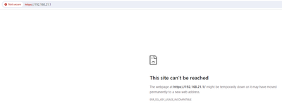

Feb 26, 2024Guide
In that case I have to report my experience is different from what you describe.
I can type in http://192.168.21.1 to Chrome normal mode, after having gone there successfully a few minutes earlier in Incognito mode, and I get this:
Note that Chrome automatically INSERTS the "s".
I can edit that URL, and delete the "s", but it keeps putting it back in.
The only thing that works is to use the full URL like this:
http://192.168.21.1/adv_index.htm
(or without the "adv_").
Whereas in Incognito mode I can type it without the page htm appended, and it doesn't insist on putting in the "s", and it works every time.
So apparently for Chrome to "remember" the insecure site, and to remember it's OK to go there in normal mode, one needs to enter the full URL including the particular page (xxxxx.htm) involved.
I'm no expert on HTML nor browsers or how they work. I'm just reporting what my experience is now.

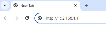

Thanks for continuing on this strange odyssey. I am using Windows 11, Chrome Version 122.0.6261.70 (Official Build) (64-bit).
Just opened Chrome again and typed in IP address of Orbi router:
Chrome has not added the 's'. When I press 'Enter', the 's' does not appear.
The same thing happens on Android 13, Chrome 122.0.6261.64 on a Samsung tablet. Enter the URL as 'http' (no 's'. nothing after the IP address). Opens the unencrypted web site. Firefox is also on this Samsung tablet. Works the same as Firefox on Windows (opens https version of Orbi web interface.) Edge on Android tablet is the same as Edge on Windows. (probably because Edge is built on Chrome.)
I cannot find a setting that will cause the 'http' to be changed to 'https'.

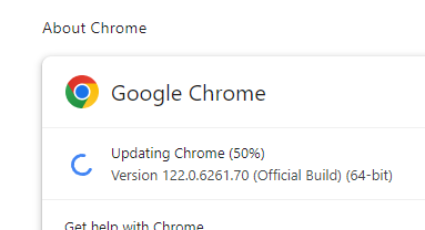

- ICPeteFeb 28, 2024Guide
OR, maybe Chrome fixed whatever was causing the problem, and pushed out a new browser version in the past 48 hours.
I don't think there's a way to turn off automatic updates in Chrome.
As of a few minutes ago I was on the same version as you: 122.0.6261.70.
As I went to check my version just now, it initiated an update all by itself, bringing me to 122.0.6261.95.
Here is a screenshot:
