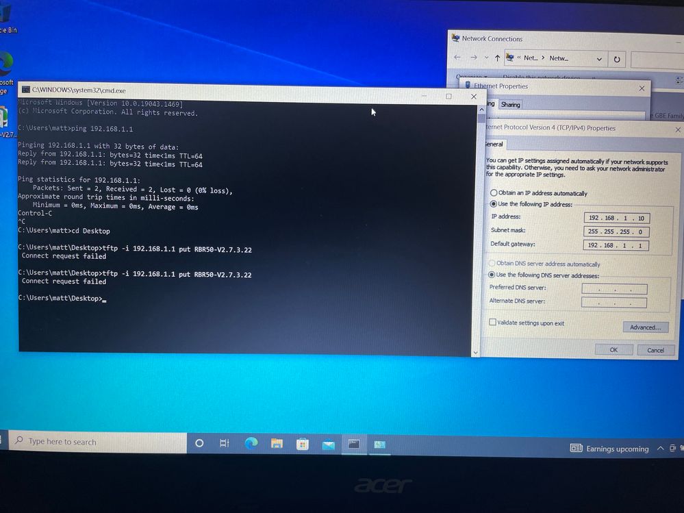

I'm reading the instructions and they say to wait upload until the Power LED flashes orange. That doesn't happen on the Orbi, fwhen do you actually upload the firmware?
- cakelyfeMar 02, 2023Guide
I am trying to upload the firmware and I constantly get connection request failed and TFTP client they recommend (not windows) is a 404 error repository not found.
I ran wireshark while trying to upload the file and I am Destination unreachable (port unreachable). I am plugged directly into the router via ethernet cable and I have tried every port on the back of the router (besides the internet port) and I get the same results. I have also tried connecting to the default wifi on the router and get the same results that way. I'm really starting to think this thing is bricked and that really annoys me.

It appears (to me) that the Orbi boot process includes a brief period of time when it will accept a TFTP connection. Too soon, and the connection fails. Too late, and the router has "moved on" to loading firmware and starting up. Hitting the "sweet spot" is not easy. On one occasion, I had failed five times in a row, and was getting ready to toss the Orbi. Then thought, "what else do I have to do right now?" On the sixth try, it worked!
So, my suggestion is:
- Power off the Orbi.
- Get the FTP process set up to the point of pressing "Send".
- Power on the Orbi.
- Count "1 potato".
- Press Send.
- If it fails, start over and this time count "1 potato, 2 potato" and press Send.

I understand that you are having difficulties with using TFTP to install firmware on your RBR50v2. Please ensure that you assign the device that you are using to TFTP the firmware to your Orbi router the IPv4 address of 192.168.1.10.
I have my ip set to 192.168.1.10
- CrimpOnMar 02, 2023Guru - Experienced User
Sorry (My Bad). I read this post to mean "not using Windows", when the context appears to be Windows.
- This web site did not work: https://pjo2.github.io/tftpd64/ ??
- Nor did https://github.com/jclehner/nmrpflash ?
Was a bit surprised to see the firmware image file with no file extension. For this Orbi, it is typically an *.img file.
- cakelyfeMar 03, 2023Guide
That was a mistake in my screenshot, the actual firmware file had a .img extension. I was able to flash the firmware using nmrpflash but I am getting the same results with the 2.7.3.22 firmware. I then downloaded an older version 2.6.1.40 and am trying that now.
