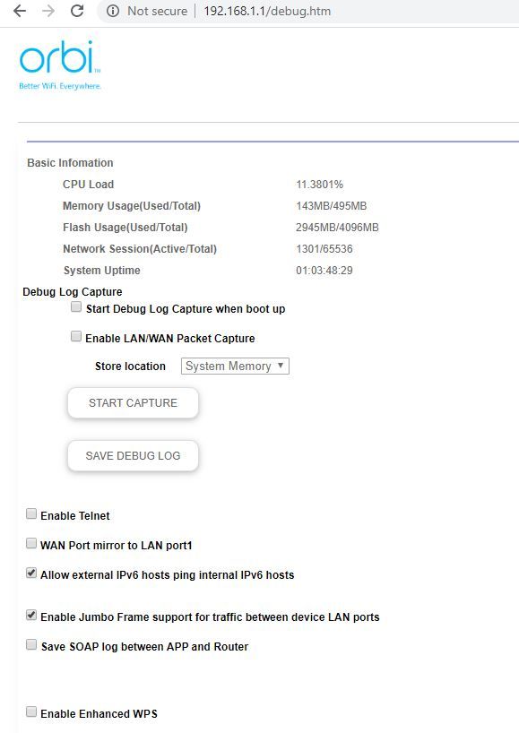

I think I have finally figured it out but I will have to observe this over the next weeks.
I realized that whenever I would reset the router and satellites to factory default using the physical reset button and then re-setup my home network, the login to portal.office.com would work for not longer than one week because of the Auto-detect setting of the IPv6.
If I disable IPV6 the portal.office.com redirection to my company's secure token service (which is used for the Authentication - just like any other enterprise would use) would again, not work.
I then noticed on the debug.htm page of the router that you have the ability to enable jumbo frames and ICMP response.
As soon as I enabled this and re-enabled IPV6 to Auto, it has started to work.
Could anyone else having a similar setup please do the same thing and confirm to me?
Could also be a good tip if others are having issues accessing AWS services.
- FURRYe38Mar 29, 2020Guru - Experienced User
Jumbo frames should only be enabled if your entire network supports Jumbo frames, i.e. switches and LAN adapters. Otherwise you should disable it.
