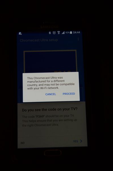

Unable to setup Chromecast Ultra over Wifi - claims it was made for a different country !!
I just bought a Chromecast Ultra at Best Buy in California and tried to set it up on my Orbi AP, bought in California also. This is the error I get . I had to use my DSLR to shoot a picture of th...
madbrain
Oct 02, 2017Luminary
A
I tried it over Ethernet and it updated its firmware and worked fine.
Unplugged Ethernet, and still faced the same issue. Couldn't set Wifi.
Then, I turned off "Implicit Beamforming" in Orbi.
I was then able to proceed with the Chromecast Ultra setup. But I still experienced the strange dialog above !
Is my Orbi really using foreign Wifi frequences ? Can I expect the FCC to come knocking at my door ?
Once the Chromecast Ultra was setup, I re-enabled beamforming. The Chromecast ultra still worked on Wifi.
Go figure !
