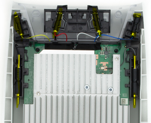

Dec 26, 2018Master
A good illustration for Orbi wireless architecture:
