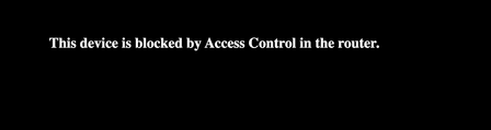

Hello I've had a RBK23 system for about a year. I am using the Access Control system to control access for my kid devices. I have been running into issues regularly since the begining. 1....

Note that the problem is solved by rebooting RBR20 or turning off/on the access control feature. So I think the issue is in the Netgear applicance.
> What browser are you using? Happes with other browsers?
Access control blocks at network level. Not http related. ICMP, SSH, etc nothing works.
