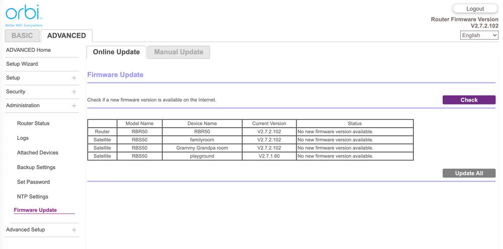

update to 2.7.2.102 on router and ALL BUT ONE satellite - how do I update the last one?
Did the "Update All" option in Orbi - Advanced - Administration - Firmware Update and my Orbi router and 2 satellites updated to V2.7.2.102 but there is one satellite stuck at V2.7.1.60. And now even when I check for new fireware, they all say that there in "No new firmware version available," even the one at V2.7.1.60.Any idea how to update the last satellite? Can't seem to find anywhere on NG site to download and do Manual Update.

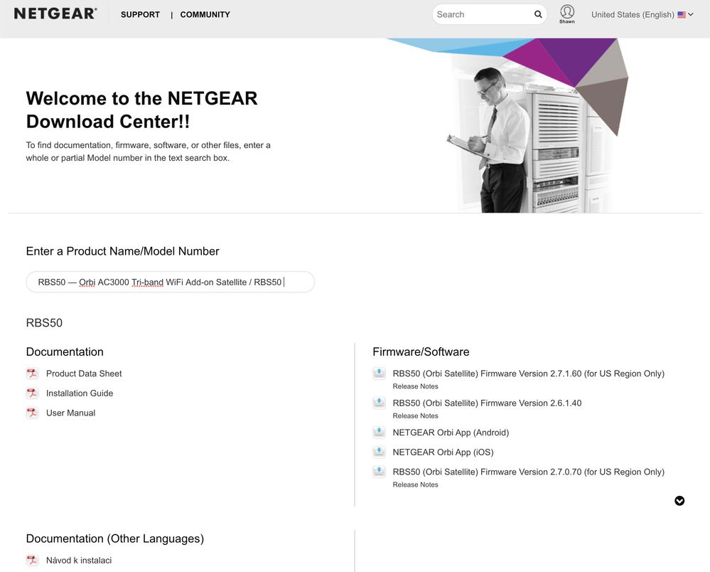

  • They're usually kept in the download area.  Look up at this page.  Once there enter your model number
    • w-k's avatar
      w-k
      yeah, I tried that. There is only 2.7.1.60
