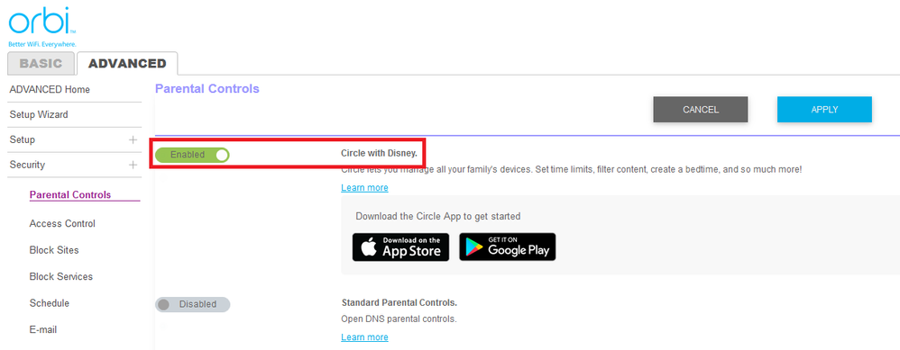

- As a test, Please disable Circle if you have it activated.Few mentioned that they had issues with VoWifi with Circle.

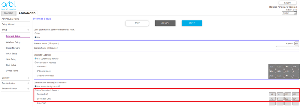

- What DNS are you using? As a test please try to change to Google's DNS 8.8.8.8 and 8.8.4.4 as follows:

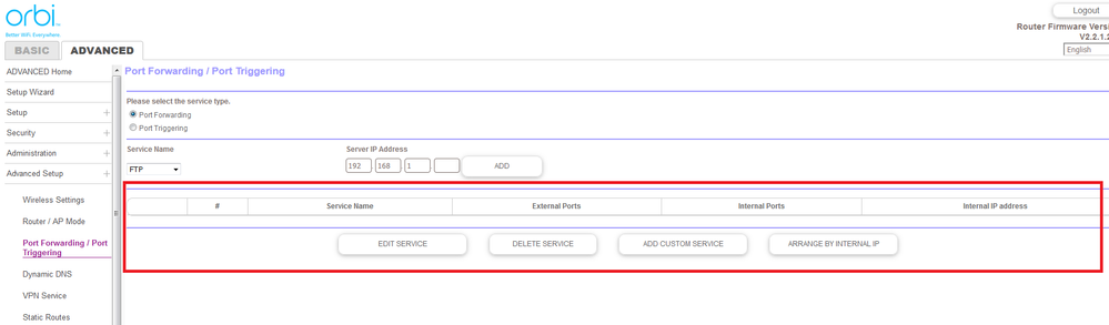

Do you use any port forwarding?
