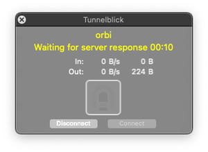

Waiting for server response when setting up VPN with Orbi on MacOS
I'm trying to connect to a VPN for work through my Orbi. I've followed the OpenVPN instructions using Tunnelbrick. When I do that I am never able to successfully connect to a server. It shows me th...

The problem is that the Orbi is blocking use of any VPN and the setup instructions (https://kb.netgear.com/25389/Enabling-VPN-service-on-a-NETGEAR-router-using-a-MAC-OS-computer) have led me to this point. I'm able to use the company VPN when I'm wired in to the modem with Tunnelbrick just fine.
