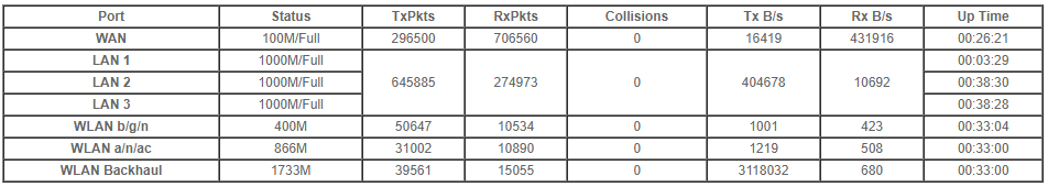

WAN speed of 100mb
My WAN setting is limiting me to 100mb as shown.  When I connect directly to my modem via ethernet my PC gets 200MB.  I've tried swapping out cables, resetting the Orbi and sattelite, even plugging in a laptop gives the same 100mb restriction when connecting to Orbi. I've swapped out cables from modem to orbi multiple times, using those that give 200 when connected to modem directly.
Any ideas on how to resolve this? Speedtest.net is how I've been testing.
Thanks
2 Replies
  • plugging in another router using the same cable, yields full download speed of 180mb.  So it's not my cable, or PC, it's the Orbi that's limiting speed to 100mb.
    Running the latest firmware on Orbi, and having it act as router
