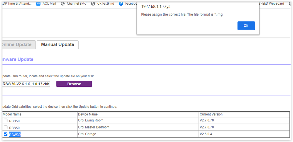

jeraboom wrote:I have a system with an RBR50, 2 RBS50s, and 1 RBW30.
When I use the router Web UI to check for firmware updates, it first attempts to download new firmware for the RBW30 and then says "Update Failed".
When I manually download the current RBW30 firmware from Netgear and go directly to the RBW30 and attempt to update the firmware, the UI there says it's already running the current version. (see attached screenshots)
Side note: I see there's an even newer version of the RBR50/RBS50 firmware (2.7.0.70), but it's not being offered to me via the Web UI update function.
Version 2.7.0.70 is actully the newest firmware available for the RBR50 router and RBS50 satellite. You would have to manually download it and install it. If you decide to update, make sure you update the satellites first, then the router.

Update still fails when I try to perform an automatic update through the router UI. Can you please remind me of the method to update the RBW30 manually, if that is what you are saying we need to do?
Thank you.
- FURRYe38Oct 21, 2020Guru - Experienced User
Do you have access to the RBWs web page? Look for the IP address on the RBRs connected devices page. Use the IP address given to the RBW to access it's web page. Log in will be same as RBR.
- Quincy56Oct 28, 2020Tutor
The file type that is included in that zip file is a .chk file. The update option in the GUI wants a .img file.
