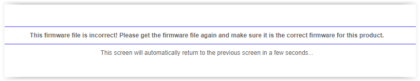

Renamed the file to .img now I get this:
jeraboom
Oct 28, 2020Star
Pretty sure the RBW takes .chk files, and the RBR and RBS take .img files. Maybe you're trying to upload to the wrong unit? Are you connecting directly to the RBW's IP address?
- Quincy56Oct 28, 2020Tutor
I'm using the main router's interface.
Connecting directly to the RBW worked to update the firmware.
The mail router's interface still says there is an update failed, but now shows the latest version.
- FURRYe38Oct 28, 2020Guru - Experienced User
Ah ok, ya, main RBR only takes .img files. Good to know that using directly RBWs web page worked.
Enjoy.
Would be good if there was a message that would say "connect directly to your RBW to update" instead of making it look like you could update from the main router interface.
