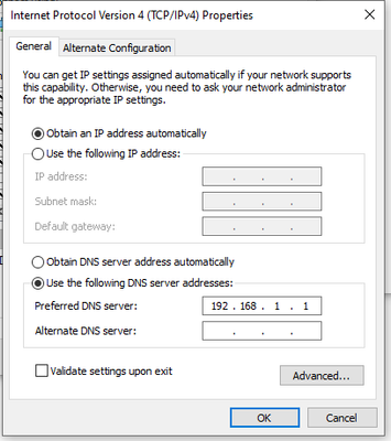

p.s. Another common diagnostic technique is to set the user computer to use specific DNS servers, rather than the router.
Most computers have an option to specify whether to use the DNS provided by the network or some others. Windows, for example, has this in the network adapter setup:
In this example, the Windows computer was told to use the Orbi router (192.168.1.1) which is what the Orbi router would have provided if "Obtain DNS server address automaticlly" was selected. (I fool with these settings all the time.)
