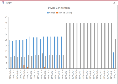

While messing around in the settings, I discovered that my main PC, intentionally set to a fixed IP address, was registered with the wrong MAC ID. As soon as I corrected this, the log has restarted to log connections again. Here is an example of one device connection:
[DHCP IP: 10.0.0.19] to MAC address 24:ee:9a:50:18:ec, Monday, April 01, 2024 13:54:01
Same graph showing recognized connections. By tomorrow the list should be back to normal.
