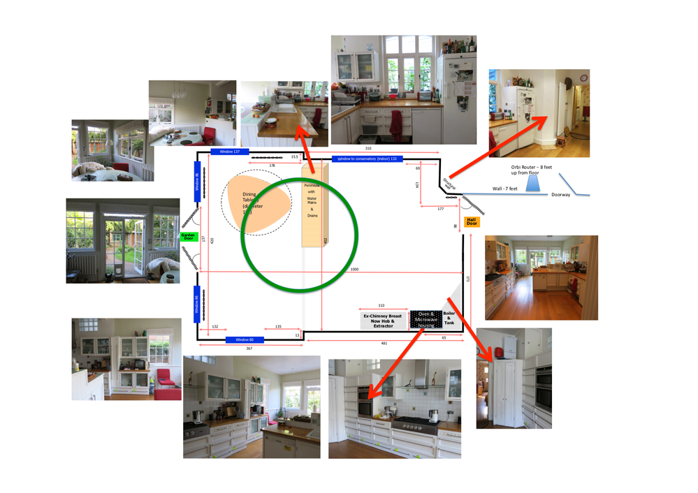

By 'dead', I mean an area in the room where the wifi signal is so low, it sometimes disappears altogether. To be precise, I have an open plan kitchen/dining room that is about 30 feet long and 16 feet wide. It is the room next to my study wherein I have set up the modem and Orbi Router. The distance from study door to kitchen door is about 10 feet and the router is poised inside the study just above the door. As you go from study to kitchen, the signal is high and steady all the way from my study, through the hall to the kitchen entrance. When you enter the kitchen, there are ovens etc immediately on the left. Nothing significantly 'metal' on the right. However, the signal there is quite good for the next 5 feet or more, even right next to the microwave. When you get past the ovens, and move forward into the open dining area, the signal drops significantly - sometimes to nil. It can also vary dramatically from full to nil within very short times, measurable in seconds rather than minutes. Oddly enough, if I continue past that area and get to the back end of the room which has doors to the garden, the signal can be slightly stronger (but still jittery) there even though it is further away from the router. It's like there is a big circular area, in the most open/uncluttered part of the room which is acting like a wifi 'Bermuda Triangle' where the wifi signals just cannot function steadily or strongly. I tried setting up the satellite in the kitchen, but it did not seem to improve the signal weakness.
I have enabled beamforming, MU-MIMO, fast roaming and dropped transmit control to 50% on Netgear's advice. The only thing left to change is the Preamble Mode which is currently set on Automatic. I've been wondering whether to change it to Long or Short, but haven't been able to find many clues in the Netgear Community forums. I am not any sort of tech pro or geek, so am out of ideas and willing to throw in the towel and go back to my Apple equipment which now does not look as incompetent as the Orbi.

If you made a drawing of the study and 30x16 open plan room, where are the ovens in relation to the Orbi above the study door? Could they be casting a "shadow" that includes that dead zone? My first step would be to relocate the router (temporarily) to the wall next to the kitchen. (maybe stand it on a cardboard box to clear the lower kitchen cabinets).

I conveniently found a picture of the room, drawn up for our kitchen designer. I superimposed on it a green ring to approximately represent the dead zone, and added the location and distance of the Router in relation to microwave, and dead zone. I'll send it in the next posting as I am having trouble making it work.

In the picture, most of the measurements are done in metric format, but my superimposed bits are measured in feet.
