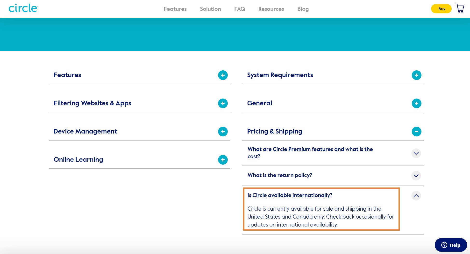

  • schumaku's avatar
    schumaku
    A firmware published for a certain region only could be regulatory related (there would be a warning in the formal release notes, not just in the referal) or for example because of a service platform e.g. for the newly added Parental Control.
    Netgear has released 2.7.0.x to select installations before, based on some undefined criteria, before using the live update.
    If the firmware is not intended for usage abroad of the US, they certainly won't distribute it using the worldwide generic live update process as what they have used for 2.5.2.4. Nothing bizarre.

        I to would like to know why US only. The Circle bug in the release notes is major and effects me badly. Crashes the router eventually, well documented elsewhere. It is the DNS daemon.
        I have installed the “US only” version in Australia and it works fine (and does indeed correct the crippling Circle bug) but why is this not made officially available to the rest of the world Netgear?
