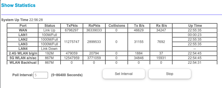

pxlla
Feb 17, 2022Tutor
Show Statistics |
| System Up Time 20:09:57 | |||||||||||||||||||||||||||||||||||||||||||||||||||||||||

- pxllaFeb 17, 2022Tutor
Hi there, I went to look in the settings, and found this but the field is blank. I've been using Wi-Fi since, but when connected via cable to the CBR40 I used the first of the four ports. (Though I tested on others.) I hope this info helps, not sure where else to look.
Hardware Version CBR40 Orbi Firmware Version V2.5.0.24_1.0.8 CM Firmware Version V1.01.06 CM Serial Number 5AK2917FA171F CM Certificate Installed CM MAC Address 10:0C:6B:6E:AC:60 LAN Port MAC Address 10:0C:6B:6E:AC:66 IP Address 192.168.1.1 DHCP On - plemansFeb 17, 2022Guru - Experienced User
Here's the WAN info from the statistics:
Port Status TxPkts RxPkts Collisions Tx B/s Rx B/s Up Time WAN Link Up 6544968 34828567 0 46315 10472 22:35:19 - plemansFeb 17, 2022Guru - Experienced User

- FURRYe38Feb 17, 2022Guru - Experienced User
What ever is pluged into LAN port 1 is only connecting at 100Mpbs and not at 1000Mpbs.
try replacing the cable with at least a cat 6 cable. And try it on different ports to see if its related to the port.
Thanks for your help, I checked that I'm using a CAT6 cable and also tried different ports. Still the same.
- plemansFeb 18, 2022Guru - Experienced User
when you switch ports, does the other port switch to 100mbps connection?
do any devices connect at gigabit speeds under the statistics page?
