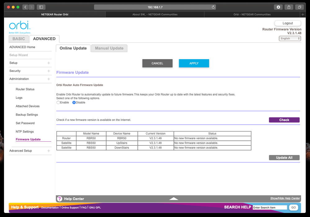

To rule out Orbi/Satellite backhaul problem, go to this page and check the "Status". Does it say "Waiting for connection" or something else?
- LyenyoApr 28, 2019AspirantHi there,
The firmware page looks fine, all 3 are saying “no new firmware available”. I have yet to check this during the droppage though. Most times I fire up the app via remote management and check the status of the satellites (which are green).
I will check this tomorrow though when it drops again.- SW_Apr 28, 2019Prodigy
If you have good backhaul connection and there's no WiFi drops right now, that's a good sign. Yeah, check it again when WiFi starts dropping...
- LyenyoMay 01, 2019AspirantSorry for the delayed reply, I had no drop outs yesterday but it seems to have started again today at 6:33pm.
I checked the firmware page and the router says “no new firmware” but both satellites were sitting on “please wait...” which I guess means it couldn’t talk to them.
