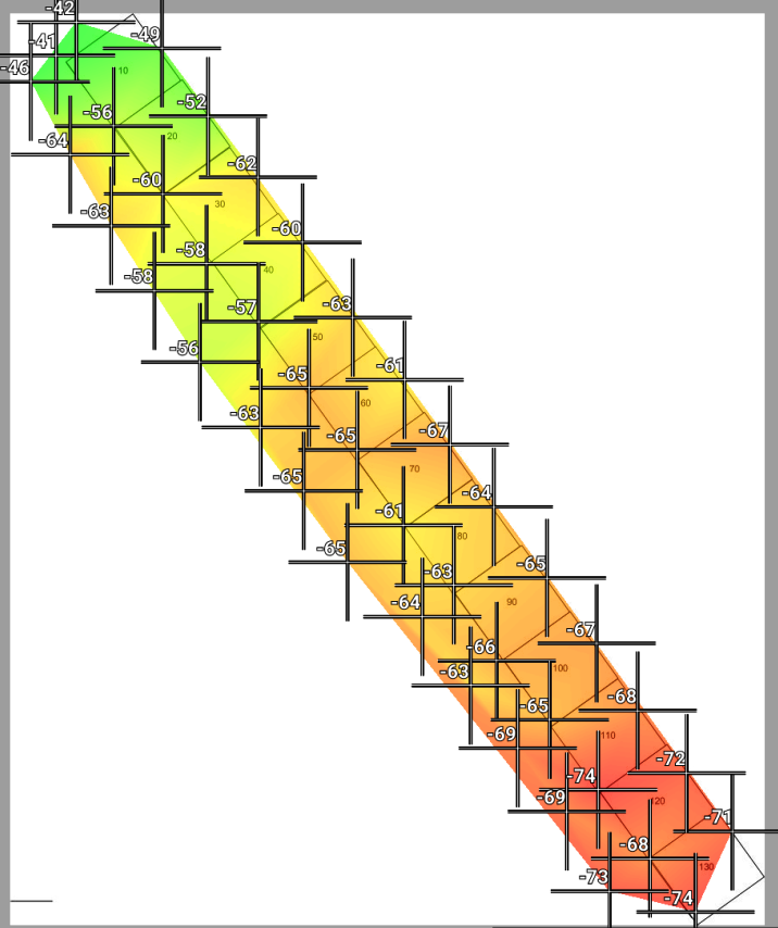

I remain puzzled about the reported WiFi signal levels. One day last fall I ran an extension cord outside and set an RBR50 on the back of my pickup truck. Then opened an Android Heat Map app on a tablet and measured the signal level as I walked farther and farther away down the sidewalk. The results are in the drawing below. My intention was to do the experiment at both 100% transmit power and 25% transmit power, but in all the excitement I just did it once and forgot to record which power level it was. (I think it was at 25%). Neighbors were beginning to comment, "sure you're alright there?"
Anyway.... at 10 ft from the truck, the app recorded about -46 dB and the signal level did not drop under under -60dB until at least 30-40 ft. It was above -70dB until well over 100ft away. I have no idea how precise this app is, or how much depends on the orientation of the tablet, etc.
If it ever warms up, I'll go back outside and repeat the experiment. Maybe next time I'll even walk around to see if signal level is affected by the orientation (front on, to the side, etc.)

I misspoke saying nothing is between the satellite and the speaker. No walls but the satellite is behind a flat screen tv to allow for an ethernet connection in the same area. There may be some interference because of that, but the same is true for the 2nd floor satellite, also behind a flat screen, and there the signal strength is higher.
After seeing your graphic, I re tested and got better numbers while standing 5 feet from the downstairs satellite. Around -39 to -41dB, which drops to around -55dB when I stand in front of the closest speaker in the kitchen. Walk 12 feet further to the paired kitchen speaker and there it's around -65dB.
